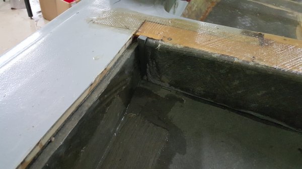

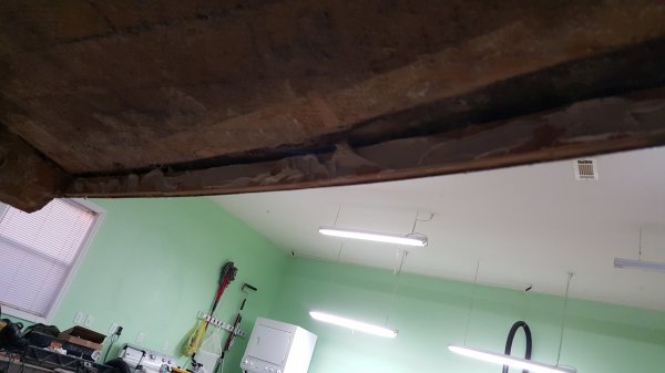

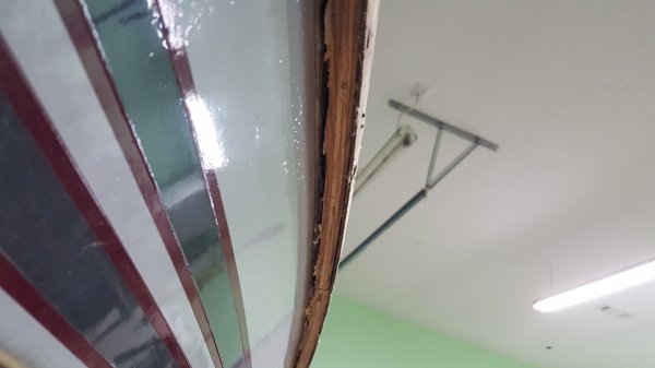

    I had to remove the deck to re-position the fuel fill hole (see how to fill a dash hole) and in the next 2 picks you will see the edge of the port side of the deck and the top of the starboard side of the hull with a light gray substance on them. That is core adhesive. underdeck1.jpg underdeck2.jpg
    Then I popped the deck on and here it is from the underside: underdeck3.jpg

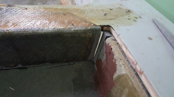

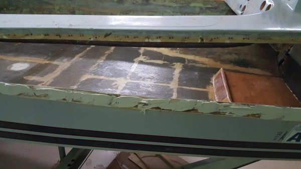

    Then I glassed the rear arch to the motorwell floor - port side pic 1st. motorwellL.jpg motorwellR.jpg
    Still working on the corners. I did use a 1/2" roundover router bit on some scrap Coosaboard to fill in the area between the motorwell sides and top of the deckbut did not want to play with the big power tools after beer. I will save that for next trip. The really nice milestone is that the deck is now permanently attached. Now I need to get some muscle over to flip the hull for bottom work.
