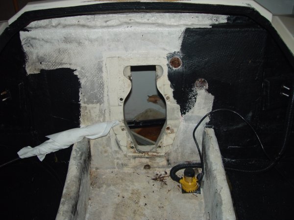

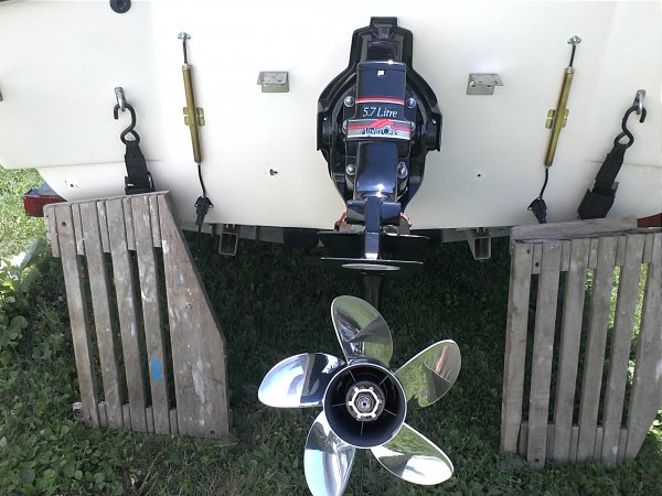

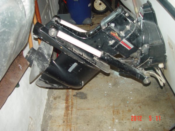

    Attached is another photo album that I call "Two Steps Forward". the pics were taken with my smart phone so they are the greatest, the last pic is a teaser of what this boat has become. Captioned are the new gauges and carling switches, the trailer in bunks rather than rollers, some shots of the outdrive. the Mercruiser ourdive looks like hell and the aluminum transom plate lost an anode bolt to corrosion which prompted me to buy a new plate. you can see where I dug my fingernail into the aluminum, not good. This discovery prompted me to purchase a new transom plate.... which lead to the replacement of the boats entire transom (which will be posted with the next batch of pics). I started detailing the engine compartment in flat black and discovered the Fglass deflection/delamination in the transom, and pulled the plug. At least the pedistals were going to be salvaged. I included a before and after side by side of one of the seat pedistals un touched and the other after using a brass brush on a drill and then applying two coats of clearcoat. The last photo is a teaser.

    This album I titled "Three Steps Backward". The pictures in this album are from a year ago and when resizing, I remembered what a PITA it was to get the old transom out in the dead of winter. With the moisture in the wood, it was harder to remove and I had no means to keep the garage heated 24/7. We did some exploratory cores which show the water intrusion in the transom but not so bad in the engine stringers. I choose to replace the transom ( for obvious reasons) and the stringers to remove any future "?" marks and make it easier to install the transom from the inside of the hull. I did the "heavy lifting" regarding the removal of the old rotted tramsom and the constuction of the new plywood transom to save a few $$ but it still was expensive. The guys at Great Lakes Marine did the transom work and were exceptional to work with.

    Attached is another photo series for the outdrive make-over. I got a bad batch of zinc chromate primer which had solvent bleed-through early on and had to do the process twice (self-etching my ass). Aluminum is a really PITA to put a coat of paint on. Did do an acid etch prior and wipe down with Isopropanol (rubbing alcohol). This was from last spring. The redo of ski-deck pics to follow.
